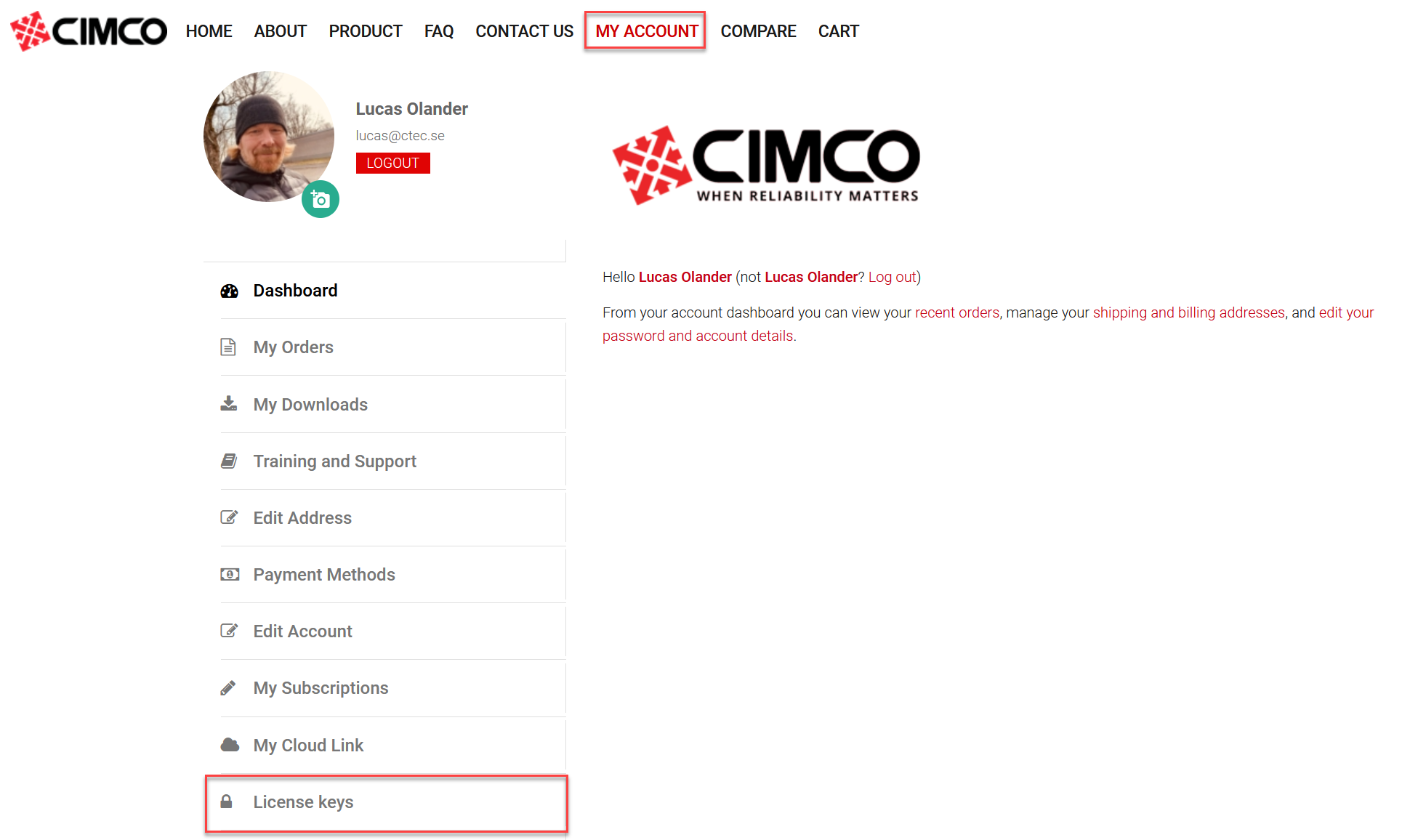

The Activation Key can be found in MY ACCOUNT under License keys.
Enter your code and click on Activatie web license.

The installer file download link is in MY ACCOUNT under MY DOWNLOADS
The Activation Key can be foundin MY ACCOUNT under License keys

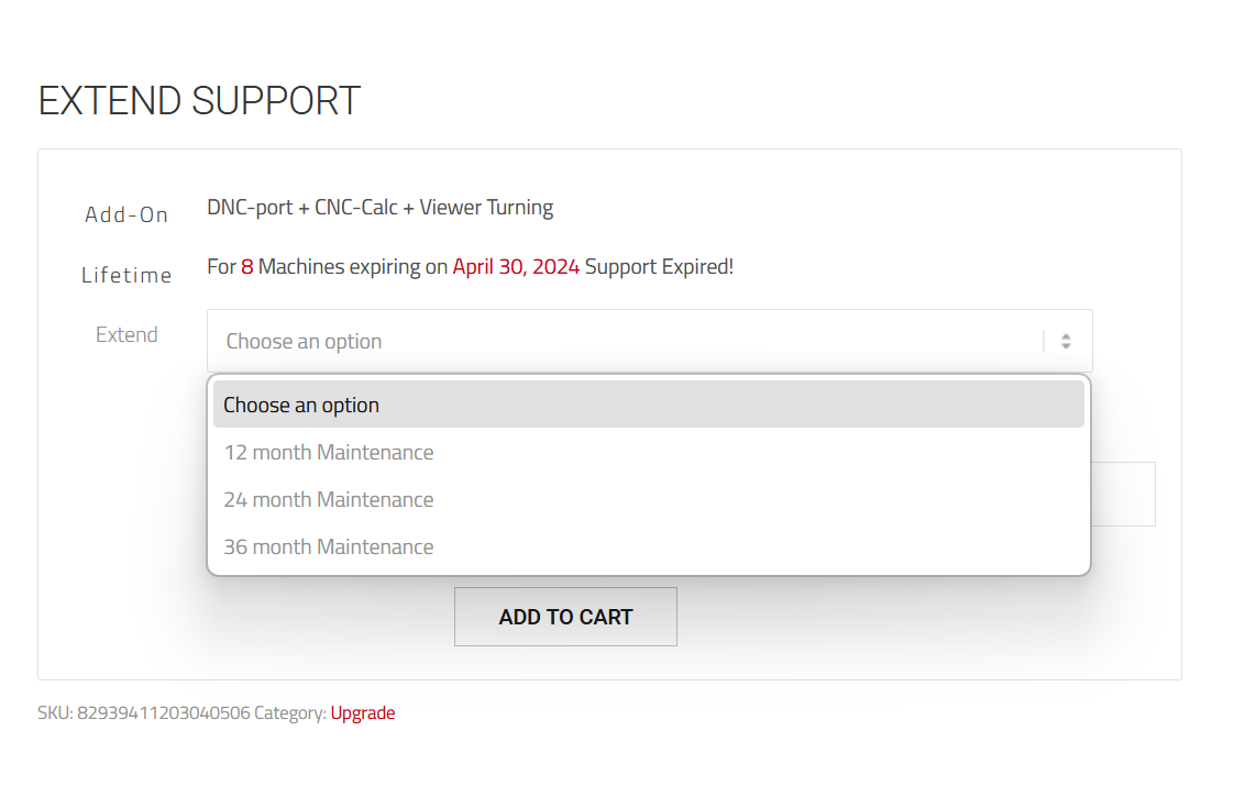

Yes, your license will work with CIMCO Edit 2022 when it’s released, if you have a valid maintenance agreement for CIMCO Edit 8.
(12 months are included in every Lifetime and OEM license)

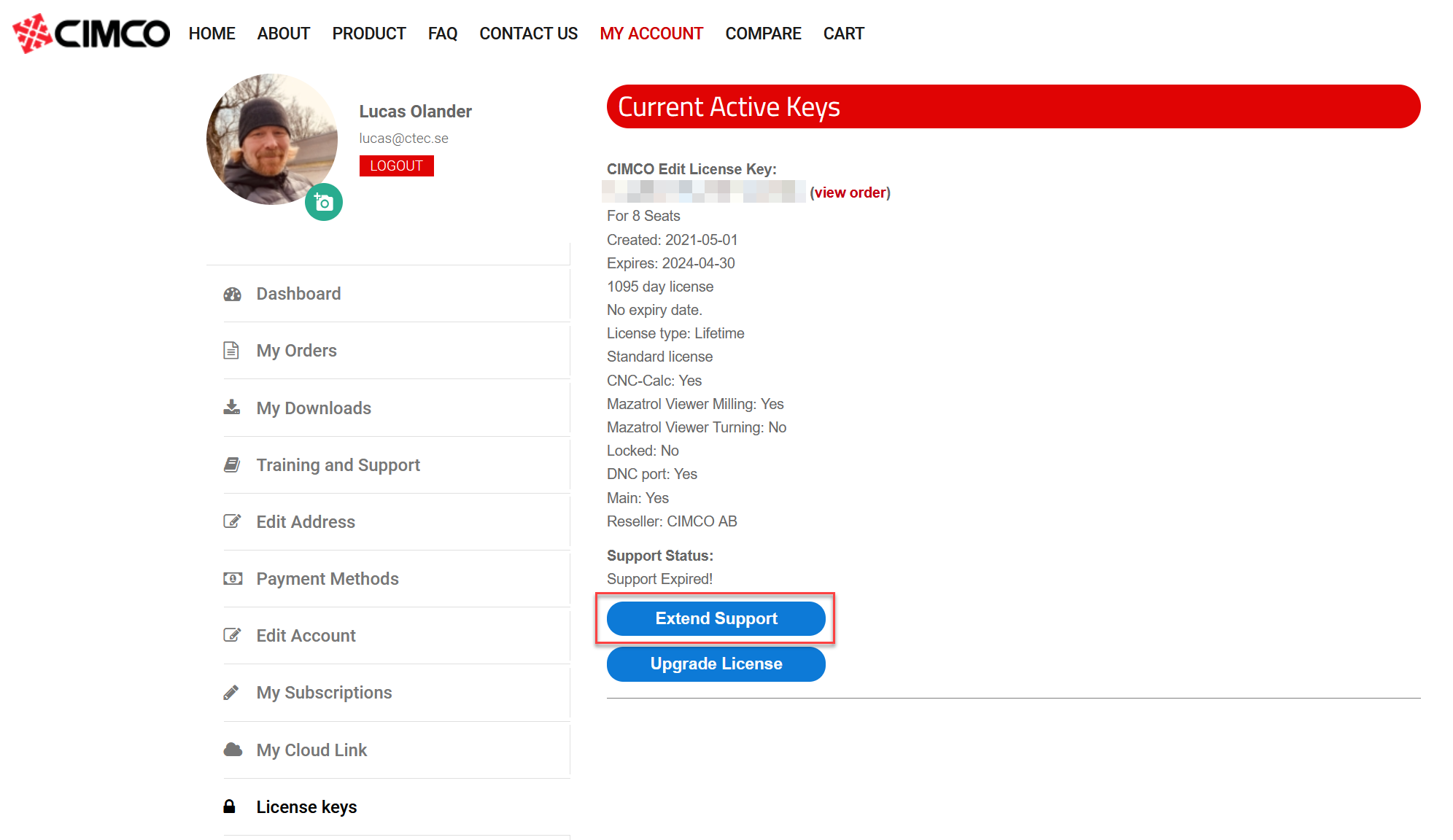

How can I add an add-on to my license?
- Log in to your account and go to [License keys]
- Find the license key you want to add a add-on to.
- Click on Upgrade License under the license details
- Select the add-on or add-ons you want to add to your license.
- After you selected the add-ons you wanted to add to your license the price for the add-on will be shown under the selection.
- When you click on add to cart we calculate the support cost and show it to you in the cart.
- The support cost is calculated on the remaining time of the main license.
